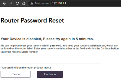

RAXE500 Your Device is disabled, Please try again in 5 minutes.
Hi,
i have this issue but after reboot the router i can access normally, after 15 min its showing this message, the RAX200 not showing any issue at all, the problem from the new router itself.
please advice.

      • FURRYe38's avatar
        What browser are you using?
        Try a different browswer, MS Edge or Firefox or Opera.
        Be sure to clear all browser caches and saved password profiles in the browser as well.
        Has a factory reset and setup from scratch been performed since last FW update? A complete pull of the power adapters for a period of time after the factory reset then walk thru the setup wizard and setup from scratch with a wired PC and web browser. Recommend setting the default DHCP IP address pool range to the following after applying and a factory reset: 192.168.#.100 to 192.168.#.200.
