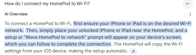

  • CrimpOn's avatar
    CrimpOn
    So, the HomePod does not connect to the WiFi network?
