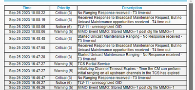

So then I checked the log and it says this:
I'm not really too sure what any of this means, but I would like to get this figured out so I don't have to keep resetting it at least once a day.

Any Criticals, Errors or Warnings seen in the event logs needs to be reviewed and resolved by the ISP. Indicates a signal issue on the ISP line up to the modem.- dahar72Aspirant
Yes. How about the Events log please.

Also you have a tone of correctables and un-correctables and should be zero.
Have the ISP check the signal and line quality UP to the modem. Be sure the ISP provisions the modem correctly.
