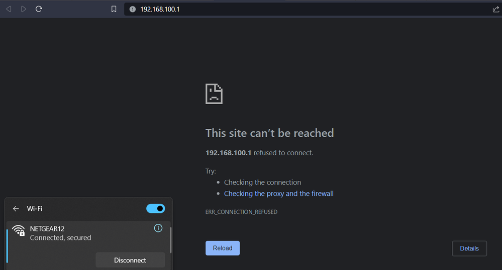

      Thanks for reaching out. Unfortunately, even though I'm connected to the router, it won't allow me to connect to 192.168.100.1 on either desktop or mobile. I also tried to connect to the router using the Nighthawk app, but I'm always receiving an "Issues connecting with NETGEAR12" message.
