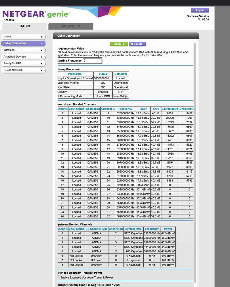

Sorry for the months of delay and i appreciate your help. I replaced the coax cable with a new one and also removed the splitter that was added my Xfinity as I only use internet with no cable TV. I thought removing the cable for a new one would fix it, but the issue is still happening.
There's no kinks in the line that I see and the new one is now installed. Removed all cables from the modem and had it completely powered off for +5 minutes.
I can include the event log, but i believe it mentions MAC so I need to blank those out right?- FURRYe38Guru - Experienced User
Power is WAY TOO HIGH:
https://kb.netgear.com/24311/Power-level-guidelines-for-a-NETGEAR-cable-modem-router
Going to burn out the modem eventually.You have a ton of correctables and un-correctables that should be zeros.
Please edit out the MAC ADDRESSES before posting the event log if you see any.
