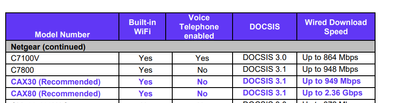

    • this xfinity document says it is recommended for the xifi/fast speeds.
      • Kitsap's avatar
        Kitsap
        Master
        XiFi/fast is not the same as Next Gen.  The 1000/100 Mbps throughput tier is part of Next Gen.  See attached.
        One more time, go here https://www.reddit.com/r/Comcast_Xfinity/wiki/knowledgebase/next-generation-internet/, scroll down to the section on eligibility.  The CAX30 is not on the list.
        A review of your cable connection status table shows you are not in a Next Gen service address.  You have no OFDMA upload channels.
