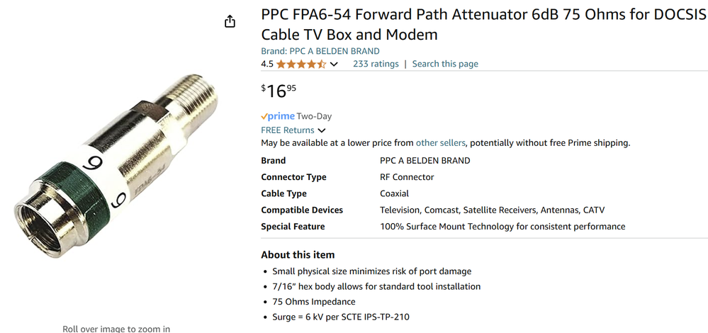

Does anyone know what would cause this difference on Channel 2? When I had a poor downstream connection last year I put the Attenuator (screenshot attached) on the cable that plugs directly into the CAX30 because my power levels were too high. That worked until now, and I noticed that Channel 2 looks like the channel id, frequency, power, etc. should be 0.
Took the Attenuator off and it makes my power levels too high like the original problem last year.
