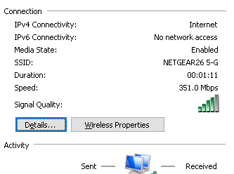

My CAX30 has low and unstable internet. My 5GHz which is supposed to go up to 800 mbps caps at 351 and fluctuates from 120-351. My 2.4GHz fluctuates  from 81 to 220 mbps on my laptop.
On startup, the speed is at its max, 800 and 300 mbps respectively. But after a few seconds, it goes down and fluctuates like I said before.

      There are 9 wireless devices connected to the router. Most of them are my families and are connected to the 2.4GHz,  as per my knowledge, there are 2 laptops and 1 phone connected to the 5GHz one.
      Are your wireless devices supporting of AX modes?
      I am not sure. The laptop in question is a Dell Latitude  E7240, so its on the older side. The other laptop, which is a Mac, that is connected also experiences slow speeds at times, so I don't think its a problem with my laptop itself.
      On ookla, I'm getting about 150 mbps.
