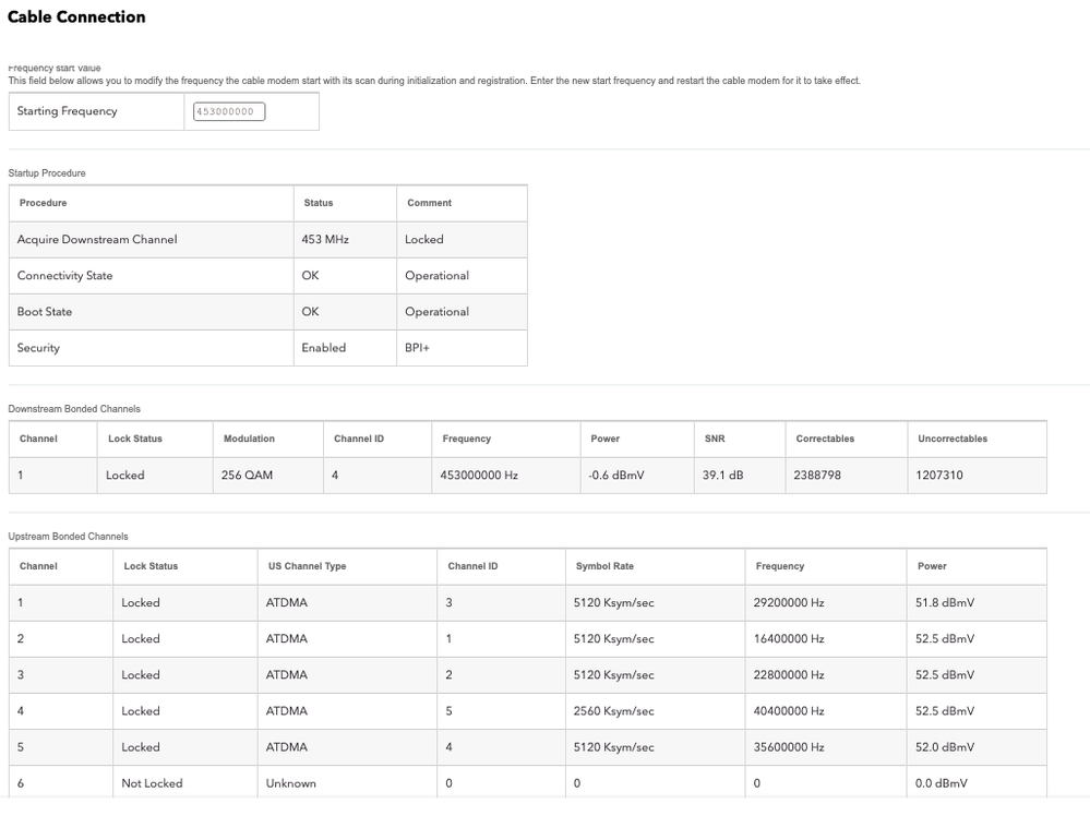

Hello, I have a CAX80 Cable Nighthawk router that we bought about a year ago.  (Hardware version: 1.01, Firmware: 2.1.1.4, Cable Firmware:1.02.08 are up-to-date)
It has worked great, solely using WiFi up until this week.
It has now twice reset the WiFi Network, which was renamed to "Broadcom" and was unsecured.  I am able to go in and reset the settings, but I have no idea why it is doing this.  Has anyone else experienced issues like this and have any ideas what is going on?  There have not been any power outages.

    Do you have a screen snip of the cable connections page and the event logs?
    I've seen ISP's trigger a new firmware install/reset process.

      plemans I just found where the event log is, but it only goes back 6 hours or so to this morning... If this happens again I'll grab the info from it.  I've included a screenshot of the cable connections page.  Everything past Channel 6 is "Not locked" showing the same information,

        photos have to be approved by a moderator. you can click on choose file and add it th at way
