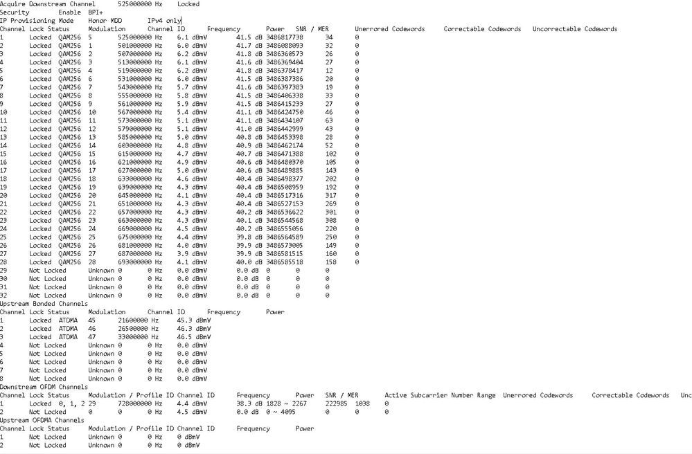

HOLY WOW. No pun. Can someone take a look at my power levels and logs and explain please!!!!????

      Frequency start Value
      This field below allows you to modify the frequency the cable modem start with its scan during initialization and registration. Enter the new start frequency and restart the cable modem for it to take effect.
      Starting Frequency
      <tabindex=-1>Startup Procedure
      Procedure Status Comment
      Acquire Downstream Channel 525000000 Hz Locked
      Connectivity State OK Operational
      Boot State OK Operational
      Security Enable BPI+
      IP Provisioning Mode Honor MDD IPv4 only
      <tabindex=-1>Downstream Bonded Channels
      Channel Lock Status Modulation Channel ID Frequency Power SNR / MER Unerrored Codewords Correctable Codewords Uncorrectable Codewords
      1 Locked QAM256 5 525000000 Hz 6.0 dBmV 41.6 dB 3313280155 33 0
      2 Locked QAM256 1 501000000 Hz 6.0 dBmV 41.6 dB 3312539433 31 0
      3 Locked QAM256 2 507000000 Hz 6.2 dBmV 41.5 dB 3312806476 24 0
      4 Locked QAM256 3 513000000 Hz 6.0 dBmV 41.2 dB 3312822332 23 0
      5 Locked QAM256 4 519000000 Hz 6.2 dBmV 41.3 dB 3312831338 10 0
      6 Locked QAM256 6 531000000 Hz 6.0 dBmV 41.3 dB 3312840341 18 0
      7 Locked QAM256 7 543000000 Hz 5.7 dBmV 41.3 dB 3312850231 17 0
      8 Locked QAM256 8 555000000 Hz 5.8 dBmV 41.0 dB 3312859285 29 0
      9 Locked QAM256 9 561000000 Hz 5.8 dBmV 41.3 dB 3312868437 26 0
      10 Locked QAM256 10 567000000 Hz 5.3 dBmV 41.0 dB 3312877720 43 0
      11 Locked QAM256 11 573000000 Hz 5.1 dBmV 40.7 dB 3312887204 58 0
      12 Locked QAM256 12 579000000 Hz 5.2 dBmV 40.8 dB 3312896860 38 0
      13 Locked QAM256 13 585000000 Hz 5.2 dBmV 40.9 dB 3312906941 27 0
      14 Locked QAM256 14 603000000 Hz 4.3 dBmV 40.6 dB 3312916161 46 0
      15 Locked QAM256 15 615000000 Hz 4.5 dBmV 40.5 dB 3312925194 97 0
      16 Locked QAM256 16 621000000 Hz 4.8 dBmV 40.5 dB 3312934288 97 0
      17 Locked QAM256 17 627000000 Hz 4.9 dBmV 40.4 dB 3312943708 133 0
      18 Locked QAM256 18 633000000 Hz 4.6 dBmV 40.0 dB 3312952484 185 0
      19 Locked QAM256 19 639000000 Hz 4.2 dBmV 40.1 dB 3312962770 180 0
      20 Locked QAM256 20 645000000 Hz 4.0 dBmV 39.9 dB 3312971392 298 0
      21 Locked QAM256 21 651000000 Hz 4.2 dBmV 40.1 dB 3312981204 254 0
      22 Locked QAM256 22 657000000 Hz 4.2 dBmV 40.0 dB 3312990511 284 0
      23 Locked QAM256 23 663000000 Hz 4.3 dBmV 39.8 dB 3312998406 282 0
      24 Locked QAM256 24 669000000 Hz 4.4 dBmV 39.9 dB 3313008921 208 0
      25 Locked QAM256 25 675000000 Hz 4.3 dBmV 39.7 dB 3313018655 228 0
      26 Locked QAM256 26 681000000 Hz 3.9 dBmV 39.8 dB 3313026789 140 0
      27 Locked QAM256 27 687000000 Hz 3.9 dBmV 39.7 dB 3313035406 152 0
      28 Locked QAM256 28 693000000 Hz 4.0 dBmV 39.6 dB 3313039853 148 0
      29 Not Locked Unknown 0 0 Hz 0.0 dBmV 0.0 dB 0 0 0
      30 Not Locked Unknown 0 0 Hz 0.0 dBmV 0.0 dB 0 0 0
      31 Not Locked Unknown 0 0 Hz 0.0 dBmV 0.0 dB 0 0 0
      32 Not Locked Unknown 0 0 Hz 0.0 dBmV 0.0 dB 0 0 0
      <tabindex=-1>Upstream Bonded Channels
      1 Locked ATDMA 45 21600000 Hz 45.3 dBmV
      2 Locked ATDMA 46 26500000 Hz 46.3 dBmV
      3 Locked ATDMA 47 33000000 Hz 46.5 dBmV
      4 Not Locked Unknown 0 0 Hz 0.0 dBmV
      5 Not Locked Unknown 0 0 Hz 0.0 dBmV
      6 Not Locked Unknown 0 0 Hz 0.0 dBmV
      7 Not Locked Unknown 0 0 Hz 0.0 dBmV
      8 Not Locked Unknown 0 0 Hz 0.0 dBmV
      <tabindex=-1>Downstream OFDM Channels
      Channel Lock Status Modulation / Profile ID Channel ID Frequency Power SNR / MER Active Subcarrier Number Range Unerrored Codewords Correctable Codewords Uncorrectable Codewords
      1 Locked 0, 1, 2 29 728000000 Hz 4.3 dBmV 37.8 dB 1828 ~ 2267 60603 421 0
      2 Not Locked 0 0 0 Hz 4.5 dBmV 0.0 dB 0 ~ 4095 0 0 0
      <tabindex=-1>Upstream OFDMA Channels
      1 Not Locked Unknown 0 0 Hz 0 dBmV
      2 Not Locked Unknown 0 0 Hz 0 dBmV

      Hey, sure! Oddly enough I posted them earlier. However, I don't see my reply here anymore. I also have some interesting log files. Maybe I am just trying to understand them better. Here are the power levels...

        Good Downstream power levels are within -7 to +7 dBmV. Good Upstream power levels are within 38-48 dBmV. so those look fine.
