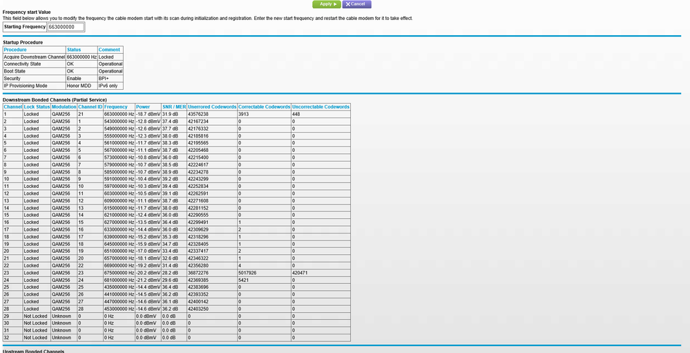

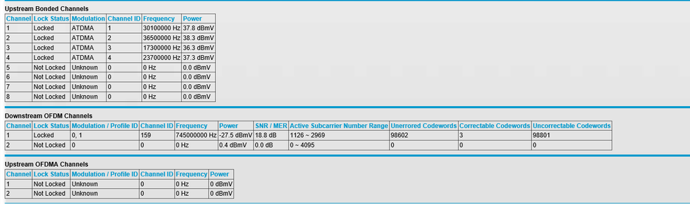

Here are the imgur links to modem information

Just saw your connection table. You have lot of noise on the RF line either caused by your home wiring or ISP directly.
you can see in the logs, you have provided there are over 400,000 uncorrectables on QAM channels and close to 100K uncorrectables on OFDM channels. This will have impact on your performance.
also, you power levels are way off. Ideally, it must be 0dBmV but Comcast has their spec with -7 to +7 dBmV.
but you have -20dB in some cases which is surprising that modem is even able to work in such bad RF conditions.
your OFDM DS power -27 !! that is way too low.
I suggest you immediately call your ISP and get the line fixed.
if you get 16ch modem, these issues may not be that bad since it will not use higher channel and OFDM channel.
Either way, your line needs to be fixed since power levels are low and too many uncorrectables.
