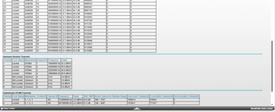

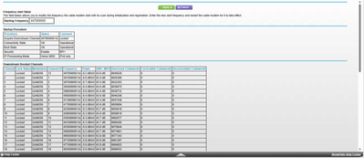

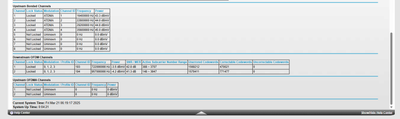

Swtiched from a Comcast XB8 gateway that was not staying in "bridge" mode to my own CM1000v2. I'm getting the expected 750mbps download on a 1gig plan, but the uploads are crazy slow (5-6mbps). I've had Comcast reprovision it twice with no improvement. I've seen on here that plan speeds of 200 or more only get 5-6mbps with these. Is that correct? Comcast chat/phone support doesn't understand the diffence between a cable channel and a modem channel and tried to get me to enable parental lock lol. I know when I had a tech out and they tested the lines, he mentioned the neighbors were missing OFDMA channels, but mine was good. Seems like the OFDMA issues are probably related, but I was getting better uploads with the XB8, although still not close to plan average. 50-100 at best when on 2Gig next gen. I switched to the CM1000v2 because we kept having issues with them and I wasn't able to get Xfinity to fix or warranty my Storm Ready wifi and Xfi pods, which are locked to their gateways and I needed to get an eero mesh system working. The XB8's kept having issues staying in bridge mode and passing connectivity to the internet.

Well power levels are are the low side but with in specs:
https://kb.netgear.com/24311/Power-level-guidelines-for-a-NETGEAR-cable-modem-router

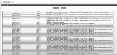

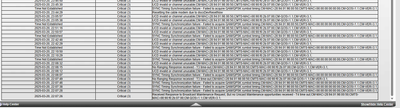

Correctables and Un-correctables are good.Please post the Event Log data from that page.

Any Criticals, Errors or Warnings seen in the event logs needs to be reviewed and resolved by the ISP. Indicates a signal issue on the ISP line up to the modem.
Have the ISP check the signal and line quality UP to the modem. Be sure the ISP provisions the modem correctly.
