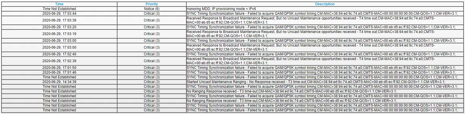

      I have the exact same problem & scenario! Purchased from Costco a month ago and every 2-3 days internet connection dropped at some random time. On average, I had to reset my modem and router 5-7 times a day. Comcast tech came out, tested the line, recrimp connectors, and the internet was back online for a few day then the nightmare return.
      Things I did differently
      I decide to trace the line myself (from the demarcation point) and found a broken 2-Way Splitter in the attic, removed the bad unit, and add a coax coupler for a straight run. Finally figure out how to configure my router (new to 802.11ac router). I have Internet through modem but not through router for several days, so I cloned the MAC address of my computer to the router (CM1100 is picky with this). I didn't need to do this with previous routers.
      I need help interpret the Event Log and Cable Connection chart. Thanks in advance.

      • FURRYe38's avatar
        So after finding the broken twoway splitter, did you remove this splitter and connect the modem directly? Splitters are not recomnended to use.
        Test the CM modem with out the wifi router online to see if it maintains connection with just a wired PC connected.
