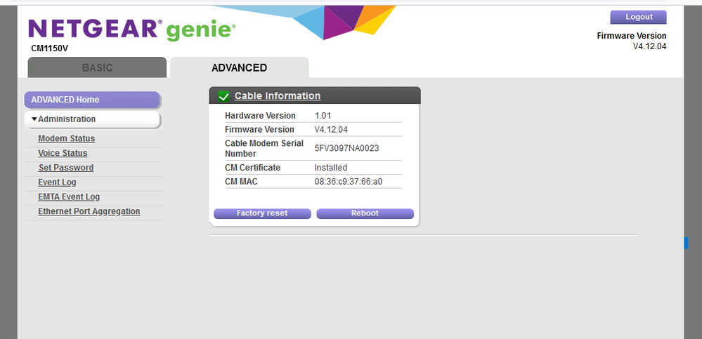

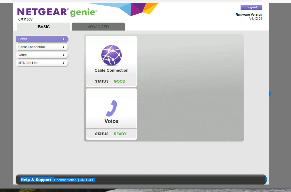

Please post a copy and paste of the modems connection status page.
Is this what you're looking for?
Select the Cable Connection button you see on the modems web page. Copy and paste what you see on that page here.
