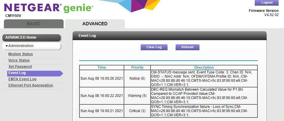

Since this drop out problem has never gone away - I've started looking at the 2 year old cable modem. The event log shows sequential Critical(3), Warning(5) and Notice(6) messages within seconds of each other as shown below;
These messages were plastered up and down the event log - some as little as an hour appart, grouped by a few seconds appart and always in the same sequence - WHAT DO THESE MESSAGES INDICATE?
How does a an average user translate this information to understand what their problems are? - I did a factory reset and it took less than 30 minutes for this sequenced log events to come up again. Is this my issue to resolve or Comcast? If its mine, what is it? If its Comcast - how do you tell them its theirs to fix when all they do is 'COVID Excuse' everything into doing nothing?

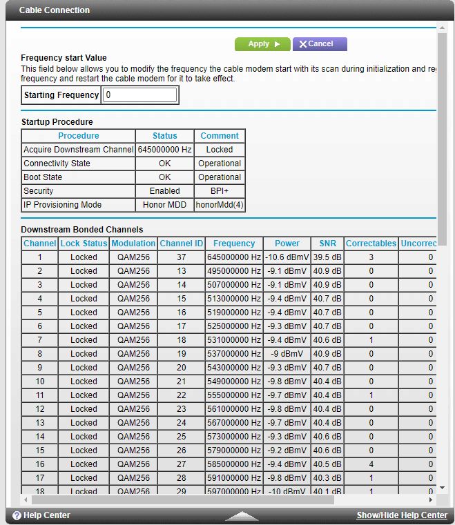

    A screen snip of the modems logs and the cable connections page helps. Not just the error you're seeing but all if it.

        You didn't get much of your logs.
        but your power levels are out of spec.
        Your a bit low on the downstream and high on the upstream.
        Meaning either you're a bit far away from the hub or you have something degrading the signal.
        Check the line for splitters or attenuators. Remove them if you have them.
        Check the cable for kinks, damage, old/bad/corroded/loose connections and remove them if you have them.
        Preferrably, move the modem to right where the coax comes into the home and connect it there. this prevents the wiring in the home from being the issue.
