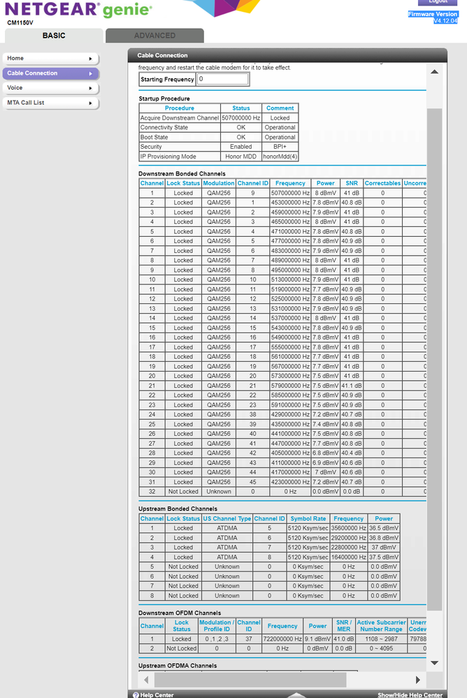

CM1150V Slow download with xfinity
Firmware Version
V4.12.04
Our service is 1200 down and we typically get about 950 down, but I don't have a network card that can do higher. Saturday our download speeds dropped to about 95 and every test I do flatlines right around there. I power cycled modem and Linksys MX4000 Velop mesh several times and same thing. Note that upload speed is the same it's been for the last year.
Calls to Comcast did no good since they claim that everything on their end looks good and I should contact Netgear. Well the modem warranty just expired and all they could do is send me a link with troubleshooting tips, but link doesn't work. So now my only Netgear choice is to pay $50 for them to possible tell me my modem isn't working and I can't do that.
There are no errors in the log.
Any thoughts?

    Power levels look pretty good.
