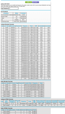

Cable connections screenshot. Just replaced cable between modem and router with a Cat6. Modem is hooked up to Google wifi hub.
Well your power levels are all over the place. Some Higher, some lower. You have correct and un-correcables that should all be zeros.
Check for ISP coax cabling and fittings and splitters. Ensure coax jack fittings are screwed in well and snug.
ISP need to check signal up to the modem. Power levels on all channels should all be in the same range.
