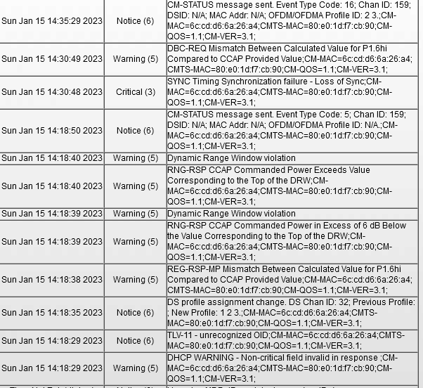

    Please post a copy and paste of the modems connection status and event log page.
    https://kb.netgear.com/30007/How-do-I-obtain-the-cable-connection-information-from-a-NETGEAR-cable-modem-modem-router
    https://kb.netgear.com/30008/How-do-I-view-or-clear-the-event-logs-on-my-NETGEAR-cable-modem-or-modem-router

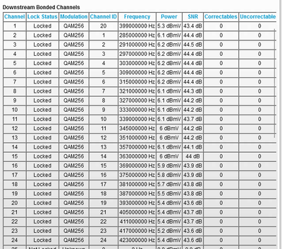

        Power levels are too high. -7Dbm is max for the CM series.
        You have Criticals nad Warnings that the ISP needs to review and resolve.

      I've also attached an updated screenshot of the cable connection status.
      I should note that to get the power levels to a reasonable level, I had to reinstall the splitter (the technician mentioned that the power level was too high and installed the splitter to assist that), so do I need to talk to the ISP about fixing the power level so that I don't need the splitter?
      • FURRYe38's avatar
        Thats much better.
        No correct or un-correctables. Thats good.
        Can keep that on or ask the ISP about a in line attenuator modulal to put behind the modem or at there connection box outside. I've got one mine as well. I use it with my CM1200 and CAX80.
