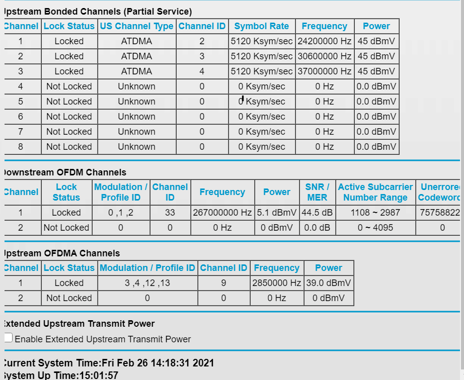

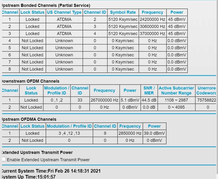

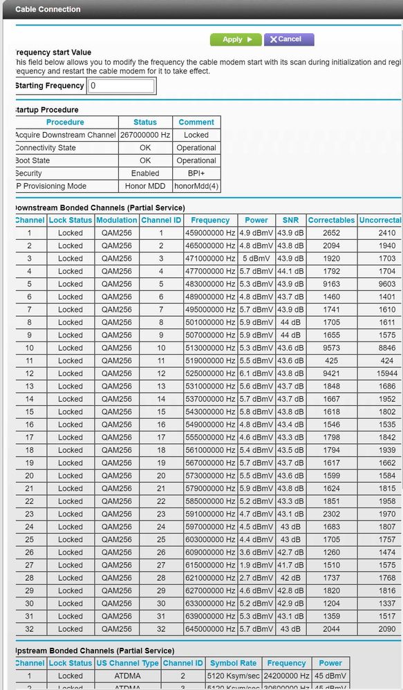

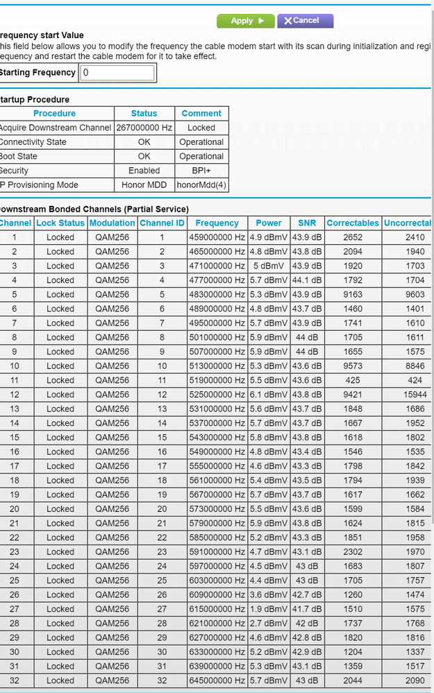

Hello,
I am experiencing problems with my CM1200 repeatedly disconnecting and reconnecting multiple times unpredictably. I have proceeded with all the usual steps of disconnect and power off, wait ~ 1min, reconnect and power on, etc but still see the issue. Doing some digging it sounds like it might be an power level issue causing the modem to reset? I'm not sure and looking at connection I think things are within spec. I'm attaching screen grabs of my connection information since the table seems to be too large for formatting here. My ISP is Spectrum and I've scheduled an appointment for them to come take a look at my connection but I wanted to check here to see if there was anything I might be missing. Thanks!

  • FURRYe38's avatar
    Have the ISP check the signal and line quality UP to the modem. Be sure the ISP provisions the modem correctly.
    Be sure there are no coax cable line splitters in the between the modem and ISP service box.
    Be sure your using good quality RG6 coax cable up to the modem.

      Thanks! I'll have them check those things, I don't think there are any splitters in the line.
      Do you have a recommendation for a good RG6 cable to use?
      • FURRYe38's avatar
        The ISP should have good RG6 Coax to use...
