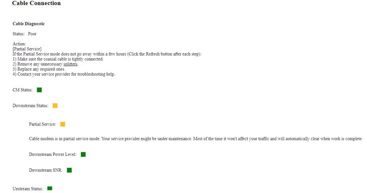

This was the status I found in my modem. (It has not changed in the past 6 hours.)
Note - the technician replaced all my coax cables and fittings. There are no splitters whatsoever. My internal/home coax cables were eliminated in one of the earlier troubleshooting steps.
Below is what the modem gave me as diagnostics:
Cable Diagnostic
Status: Poor
Action:
[Partial Service]
If the Partial Service mode does not go away within a few hours (Click the Refresh button after each step):
1) Make sure the coaxial cable is tightly connected.
2) Remove any unnecessary splitters.
3) Replace any required ones.
4) Contact your service provider for troubleshooting help.
CM Status: Good
Downstream Status: Poor
Partial Service: Poor
Cable modem is in partial service mode. Your service provider might be under maintenance. Most of the time it won't affect your traffic and will automatically clear when work is complete.
Downstream Power Level: Good
Downstream SNR Level: Good
Upstream Status: Good
Upstream Power Level: Good
Current Time: Thu Sep 21 11:13:38 2023

Download power on some channels is on the boarder of too high in power. Also power levels seems a bit all over the place, chould be with in 3db across all channels. https://kb.netgear.com/24311/Power-level-guidelines-for-a-NETGEAR-cable-modem-router
Any Criticals, Errors or Warnings seen in the event logs needs to be reviewed and resolved by the ISP. Indicates a signal issue on the ISP line up to the modem.
Have the ISP check the signal and line quality UP to the modem. Be sure the ISP provisions the modem correctly.
Be sure there are no coax cable line splitters in the between the modem and ISP service box.
Be sure your using good quality RG6 coax cable up to the modem.
Start with removing any amplifiers, signal attenuators, or splitters from the coax.
From there check the line for kinks, damage, moisture in the line.
Check the connectors for improperly made ends, foil touching the copper coax line, loose connections, bad/old/cheap connectors, or corroded connections. Replace them if you do.
Be sure to power OFF the modem for 1 minute then back ON.
