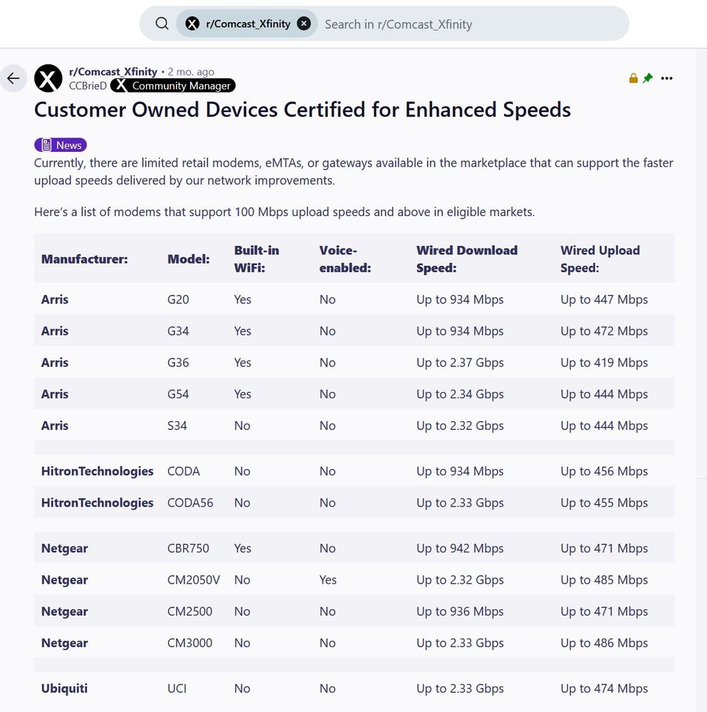

plemans, your list is out of date. Below is a screen snip from the Xfinity sub-forum over on Reddit.
