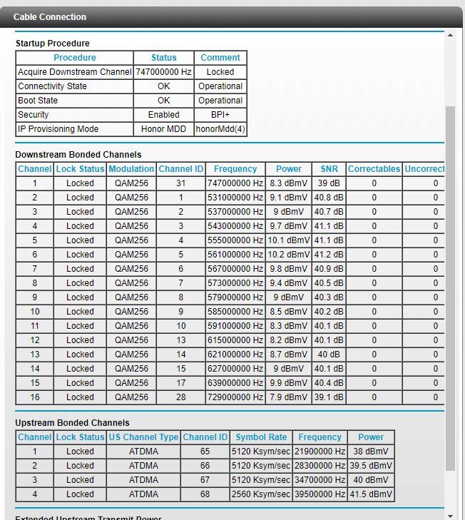

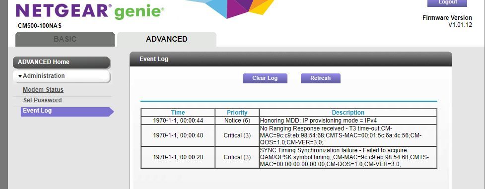

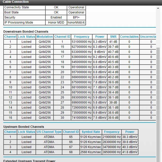

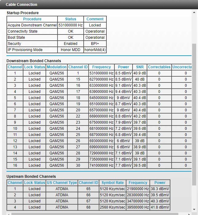

CM500 slow internet and my phone wouldn't connect
I have been having issues with my connection lately. I have rebooted both my modem and router. I have connection on my desktop, but not on my S9 phone (says connected without internet). Below is the status of my modem.
I managed to fix the problem, everything is working as it is again. I was able to contact ISP and they rebooted signals and I relocated my modem and router. All devices are back to normal. Thank you for helping out.

Power is a bit over the limits. Might ask the ISP to turn that down some:https://kb.netgear.com/24311/Power-level-guidelines-for-a-NETGEAR-cable-modem-router?article=24311
