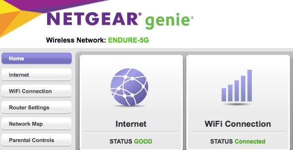

I'm trying to add my external USB HD to the router and am running into a few problems:
1) I don't know if I can use it to backup via Time Machine or only for additional storage? I followed the Time Machine guide to partition the USB drive. I'd like to be able to store backups on it. Is this possible?
2) I attached the USB drive to my router and reach the point to connect to server and keep getting an error that my MacBook cannot connect. I opened Genie and everything is good, so I'm unsure as to what the problem is.
MacBook Pro Late 2011
macOS High Sierra 10.13
Just updated Genie to 2.4.26
Any help appreciated. Thanks.

    > I opened Genie and everything is good, [...]
       Ever helpful, Netgear uses the name "Genie" for more than one thing.
    I'll assume that you're using the web interface, not some application
    program.
       Define "everything".  Define "good".  As usual, showing actual
    actions with their actual results (error messages, ...) can be more
    helpful than vague descriptions or interpretations.

      4) I referred to my MacBook so I thought that would be clear enough as to where I was using Genie... Guess not.  And GOOD was what the app said in STATUS.  See screenshot.
           The question was not where, but what.  Netgear routers have a
        web-browser interface called "Genie", and Netgear offers application
        programs for various computers/pads/phones, which are also called
        "Genie".  Are you using a web browser or one of the apps?  (Which?)
           That shows that your "Internet" status is good, which means that
        you're connected to the Internet.  It says little or nothing about your
        ReadySHARE storage.
