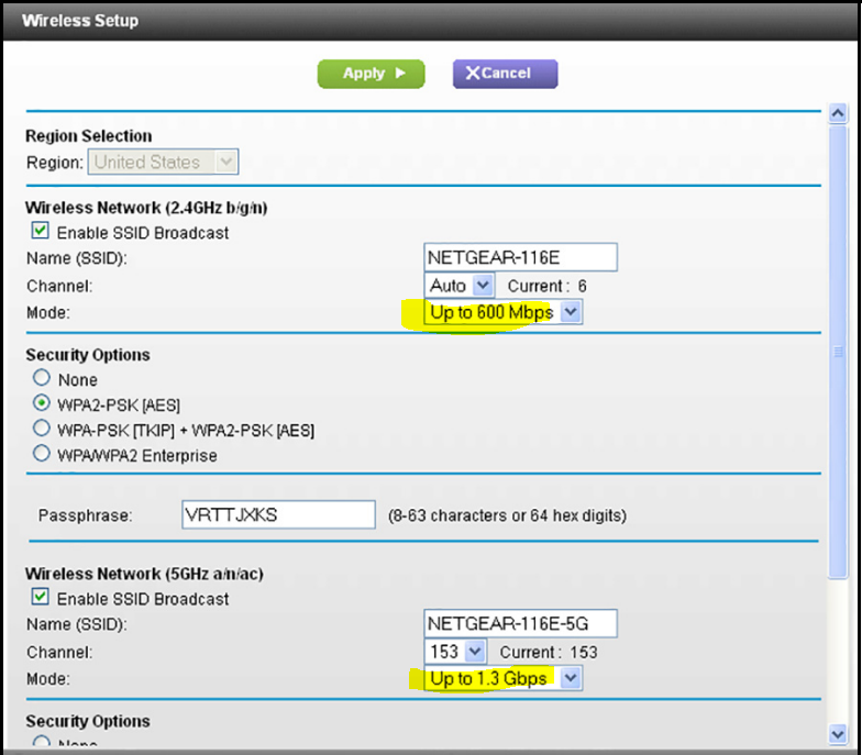

      Double check the "Mode" configured on the 2.4 and the 5 GHz band. Don't be confused - these are not  the naked wireless speeds you can achieve. Much more this does set the max bandwidth of the two bands.
      Are you located in a place where many more wireless networks are active on-air concurrently? Agee with michaelkenward - duckware has a brilliant overview and insight information on WiFi options. Yes, the 802.11ac tech is aging as we talk - technically, the C7100V is a wireless device from the last decade.
      Probably, changing (especially the 5 GHz channel) could help. Curious: What channels does the device offer to you?
