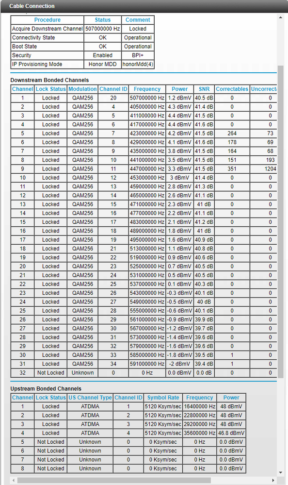

I've been using by CM1200 modem for ~2 years without issues until a couple weeks ago where I started seeing some really bad packet loss that will happen intermittently. Some of the side effects of these events are broken voice calls (I can hear others, but my mic will cut out) and huge lag spikes during gaming. I was able to verify these are happening on the first hop outside of my internal network using WinMTR (don't have those results actively available but can try to reproduce them if necessary). I'm suspecting either a faulty modem or degraded connection from my ISP. Before taking any further action (replacing modem or paying Comcast to come out) I was hoping someone might be able to provide guidance from my modem's power logs.

Yes, there is a Netgear R7000 router. I see this issue on both WiFi and Ethernet connections. As alluded to earlier, the packet loss appears at the second hop outside of my LAN so I don't suspect the router. But I can potentially remove that device from the equation to run further tests. - Please post a copy and paste of the modems connection status page.

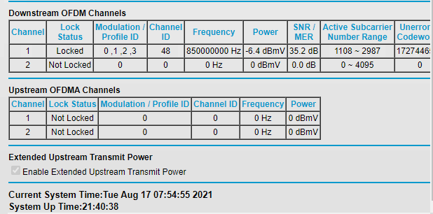

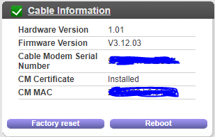

The connection is listed as "Good" and attaching the Cable Information page. Is this what you are referring to? - Have the ISP check the signal and line quality UP to the modem. Be sure the ISP provisions the modem correctly.

I've reviewed most of the self-help documents and I was hoping someone can help me parse my modem power level logs to see if there's any failures that can be discerned through the modem itself.

Ahh... I just realized my image uploads might be getting swallowed up. Here's an imgur link: https://imgur.com/iTKLDGG
