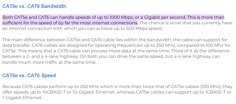

    So_tired wrote:
    That the time outs could be because the cat5e can handle up to 100mbps upload and the cm2500 pushes far past that to 156mbps+.
    Internet search turns up plenty of references that Cat5e cable is capable of 1Gbps data rate, such as this one:
    and this one:
    The Ethernet cable connecting ISP modem and customer router is not 100 meters in length.  (more like 2 meters)
    There is nothing wrong about installing a Cat6 cable.  Swapping cables is one of the most frequently suggested troubleshooting steps.
