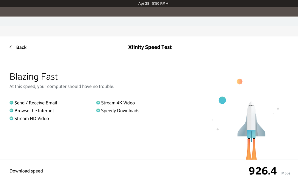

    • patricia2626's avatar
      patricia2626
      Idid it does give me fully the speed i paid for but i cant make wifi router internet ports at least one of them give me atleast 900 and not sure what else do i need to buy.
      I only get full speed without the router and qos is off and some times streaming i get slow downs and dchp on screen.
        Ok So you've figured out that the CM1100, if directly connected, gives you full gig service? if this is so, your modem is giving you full speed and performing as expected. This question needs to be posted in the router forum for the R8000 instead of the modem forum. They're great at helping troubleshoot why routers aren't giving full service or having gproblems.
