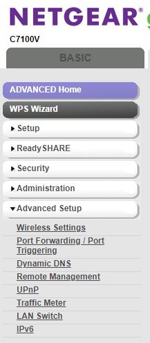

This has been working fine for past 2 years.  Just noticed today that I cannot access printer and drive.  When I log in to router, the printer or drive does not show up; USB Control Center shows nothing connected.  I have re-installed software for control center & printer as well as cold booted router and computer several times with no change.  I viewed a post about page 53 in manual but do not have a USB settings under the Avanced /Advanced Setup (see attached screenshot).  I also have un-plugged & plugged in the printer & drive USB cables.  The drive lights up as it should & the printer comes on and goes through it's check.

      I have attached 2 screen shots of ready share from the Gateway for the router.
      The top one is ready share showing no USB storage even though a drive is connected.
      The bottom one is after I select the ready share printing, the screen comes up as if no printer is connected even though one is.
      This may mean nothing but, if the printer was turned off, I could not access the USB drive.  If the power went out for any period of time long enough for the printer to shut off then came back on, I could not access the USB drive until I turned the printer on.
      This worked fine before and nother has changed.  I'm beginning to wonder if the USB part of the router is bad.
