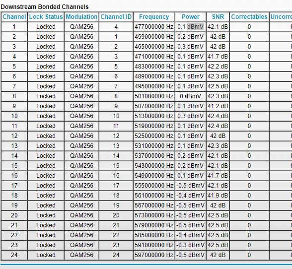

I have a Nighthawk AC1900 WiFi Cable Modem Router with xfinity internet service that intermittently drops offline.  I called Netgear when I this first happened at the time of purchase (modem is about 6 months old) and they told me its because my dBmV range needs to be over .3 (maybe .5?) for all channels.  They had me plug my modem in different outlets to see if the power would increase, however it pretty much stayed in the same dBmV range.  Ive pasted a screenshot of the channels below.  Ill admit, Im no expert when it comes to these things.  I asked the Netgear rep if there was anything I could do and all she said was to keep trying different outlets in the house.  I tried a bunch but no luck.  The modem for a few months after talking with netgear worked fine, but now over the past couple months since , has been intermittently dropping.  Anyone else have this same issue and if so, any solutions????

    Looks to be with in spec:
    https://kb.netgear.com/24311/Power-level-guidelines-for-a-NETGEAR-cable-modem-router?article=24311
    Have the ISP check the signal and line quality UP to the modem. Be sure the ISP provisions the modem correctly.
    Be sure there are no coax cable line splitters in the between the modem and ISP service box.
    Be sure your using good quality RG6 coax cable up to the modem.
    Be sure to power OFF the modem for 1 minute then back ON.
    https://community.netgear.com/t5/Cable-Modems-Routers/General-info-and-Troubleshooting-for-Cable-Modems/m-p/1530376#M12853
    https://www.duckware.com/tech/solving-intermittent-cable-modem-issues.html
    • plemans's avatar
      plemans
      Your power is spot on and you have no errors currently. but thats just a snap shot.

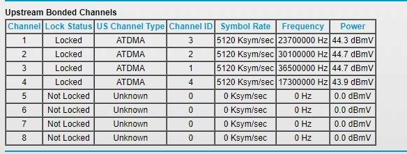

      Got a screen snip of the event logs? and the upstream info?
      • chrisnh03's avatar
        chrisnh03
        Tutor
        Thanks for the feedback plemans.  As I mentioned in a previous reply, I couldve sworn the Netgear rep told me the downstream power needs to be at .5...buy maybe Im not rembering the conversation well.  Either way, upstream info and event logs are below.
        Thanks for looking
