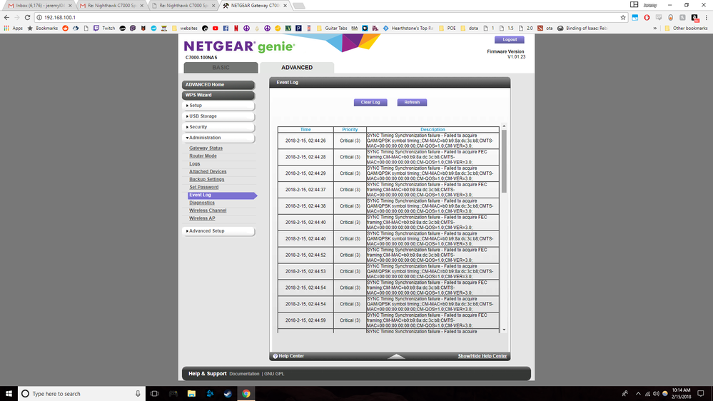

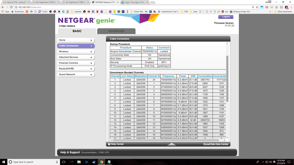

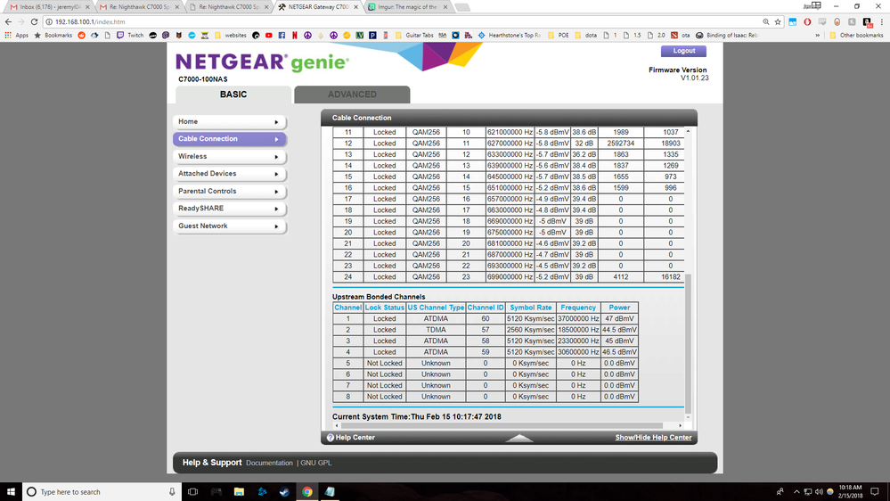

    • heylookitsemus's avatar
      heylookitsemus
      Sorry didn't specify. What I meant by "wired connection" is the connection to my computer via ethernet cable. Brand new cable. The connection will be working just fine and then will drop for a couple or few minutes then get back on. However, the connection on other devices via wifi don't drop when the wired ethernet connection drops.
      • vkdelta's avatar
        vkdelta
        NETGEAR Employee Retired
        your logs/screenshots were not attached in your message. Please attach them again here.
