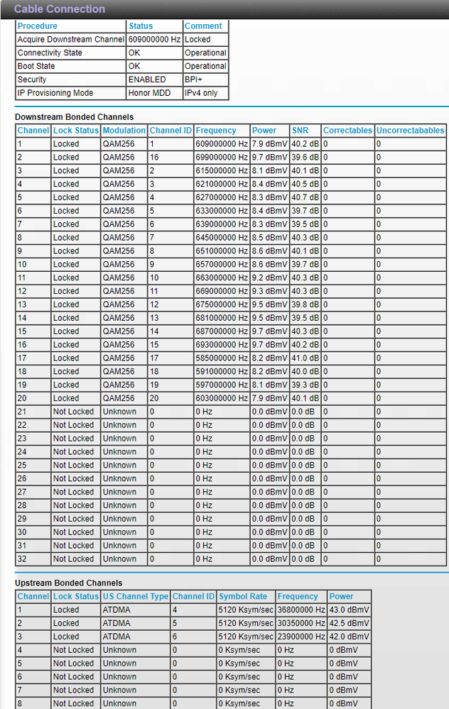

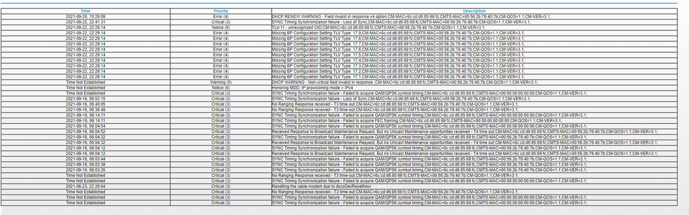

    2. do you have a screen snip of the cable connections page and the event logs? that helps us check line connections. It wouldn't be the first time during swapping a modem that a cable went bad. Check all the cables/connectors for kinks, damage, old/bad/corroded/loose connections.

      I do have a couple screenshots of those screens; unfortunately I'm not savvy enough to glean very much information from them myself. Screenshots will be at the bottom of this reply.
