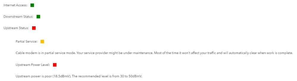

I just got a AX6000 WiFi Cable Modem Router (CAX80) yesterday and have been getting constant ping spikes in games and such every 30-45 seconds ever since. I am running on firmware v2.1.3.5. I replaced my default Xfi Gateway from Xfinity with this but was having no issues beforehand using the other modem/router combo. When going to 192.168.1.1 in my web browser and looking at my Netgear panel it is showing my cable connection status as poor. When I go into the diagnostic for it everything is green apart from my upstream status which is showing red. I should also add that I am using the same coax cable and ethernet cables that I was using previously so the only thing that has changed is the router/modem itself. Any help would be appreciated.

I am not sure if this is what you are reffering to or not, I also have a technician coming out on Saturday to look everything over.
Procedure Status Comment Acquire Downstream Channel 405 MHz Locked Connectivity State OK Operational Boot State OK Operational Security Enabled BPI+ Downstream Bonded Channels Channel Lock Status Modulation Channel ID Frequency Power SNR Correctables Uncorrectables 1 Locked 256 QAM 1 405000000 Hz 5.4 dBmV 40.4 dB 16 0 2 Locked 256 QAM 2 411000000 Hz 5.5 dBmV 40.4 dB 1 0 3 Locked 256 QAM 3 417000000 Hz 5.6 dBmV 40.4 dB 0 0 4 Locked 256 QAM 4 423000000 Hz 5.5 dBmV 40.5 dB 0 0 5 Locked 256 QAM 5 429000000 Hz 5.4 dBmV 40.4 dB 0 0 6 Locked 256 QAM 6 435000000 Hz 5.7 dBmV 40.5 dB 0 0 7 Locked 256 QAM 7 441000000 Hz 5.8 dBmV 40.4 dB 0 0 8 Locked 256 QAM 8 447000000 Hz 5.8 dBmV 40.5 dB 0 0 9 Locked 256 QAM 9 453000000 Hz 5.9 dBmV 40.5 dB 1 0 10 Locked 256 QAM 10 459000000 Hz 6.0 dBmV 40.5 dB 0 0 11 Locked 256 QAM 11 465000000 Hz 6.0 dBmV 40.6 dB 0 0 12 Locked 256 QAM 12 471000000 Hz 6.0 dBmV 40.5 dB 1 0 13 Locked 256 QAM 13 477000000 Hz 6.4 dBmV 40.7 dB 0 0 14 Locked 256 QAM 14 483000000 Hz 6.5 dBmV 40.7 dB 1 0 15 Locked 256 QAM 15 489000000 Hz 6.4 dBmV 40.6 dB 0 0 16 Locked 256 QAM 16 495000000 Hz 6.5 dBmV 40.7 dB 0 0 17 Locked 256 QAM 17 507000000 Hz 6.7 dBmV 40.8 dB 0 0 18 Locked 256 QAM 18 513000000 Hz 6.6 dBmV 40.7 dB 0 0 19 Locked 256 QAM 19 519000000 Hz 6.6 dBmV 40.7 dB 1 0 20 Locked 256 QAM 20 525000000 Hz 6.3 dBmV 40.6 dB 0 0 21 Locked 256 QAM 21 531000000 Hz 6.3 dBmV 40.7 dB 0 0 22 Locked 256 QAM 22 537000000 Hz 6.2 dBmV 40.6 dB 0 0 23 Locked 256 QAM 23 543000000 Hz 6.3 dBmV 40.6 dB 0 0 24 Locked 256 QAM 24 549000000 Hz 6.3 dBmV 40.6 dB 0 0 25 Locked 256 QAM 25 555000000 Hz 6.2 dBmV 40.6 dB 0 0 26 Locked 256 QAM 26 561000000 Hz 6.4 dBmV 40.5 dB 0 0 27 Locked 256 QAM 27 567000000 Hz 6.4 dBmV 40.7 dB 0 0 28 Locked 256 QAM 28 573000000 Hz 6.0 dBmV 40.6 dB 0 0 29 Locked 256 QAM 29 579000000 Hz 6.1 dBmV 40.5 dB 0 0 30 Locked 256 QAM 30 585000000 Hz 6.3 dBmV 40.6 dB 0 0 31 Locked 256 QAM 31 591000000 Hz 6.0 dBmV 40.4 dB 0 0 32 Not Locked Unknown 0 0 Hz 0.0 dBmV 0.0 dB 0 0 Upstream Bonded Channels (Partial Service) Channel Lock Status US Channel Type Channel ID Symbol Rate Frequency Power 1 Locked ATDMA 1 5120 Ksym/sec 35600000 Hz 25.5 dBmV 2 Locked ATDMA 2 5120 Ksym/sec 29200000 Hz 19.5 dBmV 3 Locked ATDMA 3 5120 Ksym/sec 22800000 Hz 24.0 dBmV 4 Locked ATDMA 4 5120 Ksym/sec 16400000 Hz 18.0 dBmV 5 Not Locked Unknown 0 0 0 0.0 dBmV 6 Not Locked Unknown 0 0 0 0.0 dBmV 7 Not Locked Unknown 0 0 0 0.0 dBmV 8 Not Locked Unknown 0 0 0 0.0 dBmV Downstream OFDM Channels Channel Lock

Codewords1 Locked 0 ,1 ,2 ,3 37 690000000 Hz 7.08 dBmV 40.3 dB 1108 ~ 2987 69359296 66542954 44 2 Not Locked 0 0 0 Hz 0 dBmV 0 dB 0 ~ 4095 0 0 0 Upstream OFDMA Channels Channel Lock Status Modulation / Profile ID Channel ID Frequency Power 1 Not Locked 0 0 0 Hz 0 dBmV 2 Not Locked 0 0 0 Hz 0 dBmV - FURRYe38Guru - Experienced User
Power levels look ok:
https://kb.netgear.com/24311/Power-level-guidelines-for-a-NETGEAR-cable-modem-router?article=24311
I'm seeing some correctables on the down, and some on the UP link. Something the ISP needs to look into. These should all be zero.
Be sure when you ping and speed testing, that your using a wired PC connected to the modem. Ensure you don't have any background running apps on the PC running when your testing.
