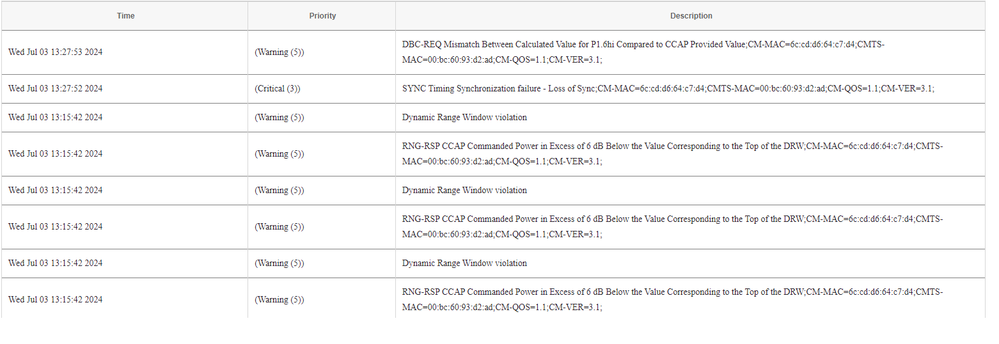

Nighthawk cm2000 connected to spectrum router. Wifi is marking fair in bedroom where desktop is
I'm having issues with being able to receive good a good WiFi connection in my bedroom. I currently have a nighthawk cm2000 modem connected to a Spectrum router model (SAX2V1S). I do not have the biggest apartment so I'm wondering what could be causing this to have a poor connection? I have a buddy that just keeps mentioning to look for the best modem settings and to change them on my end. I have looked but have not found any answers to this. I am also not very knowledgeable when it comes to these things. It was suggested to implement a WiFi extender but i am curious to know if that is really needed. Any sort of help will be appreciated. I have provided an event log since it seems that's what a majority of people do. Firmware is V1.01.06.

https://kb.netgear.com/30007/How-do-I-obtain-the-cable-connection-information-from-a-NETGEAR-cable-modem-modem-routerAny Criticals, Errors or Warnings seen in the event logs needs to be reviewed and resolved by the ISP. Indicates a signal issue on the ISP line up to the modem.
