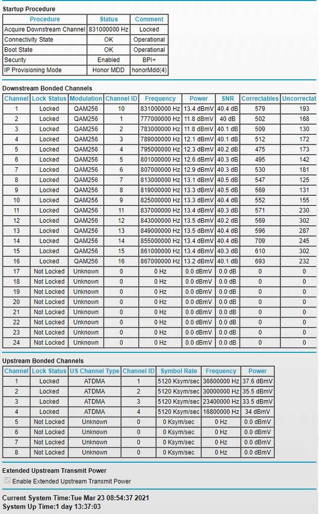

- plemansGuru - Experienced User
do you have a screen snip of the cable connections page and event logs?
that helps us check the connection back to the isp.
they're great at saying "its not our line".
And it might not be.
Check you coax line for kinks, bad/old/loose connectors, moisture in the line, etc.
Also, if you have any splitters, amplifiers, or attenuators, remove them from the line. preferable, directly connect the c7000 to where the coax comes into the home to prevent the wiring in the home from being the issue.
- Infosec_stoicAspirant
Hello! thank you for getting back to me.
I went ahead and I checked the coax connection to the C7000V2. I even double checked the outside cable line to make sure that there wasn't any damage to the outside box. Doesn't appear to be anything out of the ordinary. I just have the one coaxial connection directly to the modem/router no other splitters, amplifiers, or attenuators.
Here's the output from the event logs below kind of a bummer they don't have a export option so a copy and paste will have to do.
Time
Priority Description 2021-3-23, 09:01:12 Warning (5) MDD message timeout;CM-MAC=44:a5:6e:83:05:48;CMTS-MAC=00:27:90:0c:d0:7c;CM-QOS=1.1;CM-VER=3.0; 2021-3-22, 13:55:59 Critical (3) Received Response to Broadcast Maintenance Request, But no Unicast Maintenance opportunities received - T4 time out;CM-MAC=44:a5:6e:83:05:48;CMTS-MAC=00:27:90:0c:d0:7c;CM-QOS=1.1;CM-VER=3.0; 2021-3-22, 13:55:20 Error (4) Improper Configuration File CVC Format 2021-3-22, 13:55:12 Notice (6) TLV-11 - unrecognized OID;CM-MAC=44:a5:6e:83:05:48;CMTS-MAC=00:27:90:0c:d0:7c;CM-QOS=1.1;CM-VER=3.0; 2021-3-22, 13:55:10 Warning (5) DHCP WARNING - Non-critical field invalid in response ;CM-MAC=44:a5:6e:83:05:48;CMTS-MAC=00:27:90:0c:d0:7c;CM-QOS=1.1;CM-VER=3.0; 2021-3-22, 13:55:02 Notice (6) Honoring MDD; IP provisioning mode = IPv4 2021-3-22, 13:55:01 Critical (3) Started Unicast Maintenance Ranging - No Response received - T3 time-out;CM-MAC=44:a5:6e:83:05:48;CMTS-MAC=00:27:90:0c:d0:7c;CM-QOS=1.0;CM-VER=3.0; 2021-3-22, 13:54:43 Critical (3) SYNC Timing Synchronization failure - Failed to acquire QAM/QPSK symbol timing;;CM-MAC=44:a5:6e:83:05:48;CMTS-MAC=00:00:00:00:00:00;CM-QOS=1.0;CM-VER=3.0; 2021-3-22, 13:54:42 Critical (3) SYNC Timing Synchronization failure - Failed to acquire FEC framing;CM-MAC=44:a5:6e:83:05:48;CMTS-MAC=00:00:00:00:00:00;CM-QOS=1.0;CM-VER=3.0; 2021-3-22, 13:54:41 Critical (3) Received Response to Broadcast Maintenance Request, But no Unicast Maintenance opportunities received - T4 time out;CM-MAC=44:a5:6e:83:05:48;CMTS-MAC=00:27:90:0c:d0:7c;CM-QOS=1.1;CM-VER=3.0; 2021-3-22, 13:54:18 Critical (3) SYNC Timing Synchronization failure - Failed to acquire QAM/QPSK symbol timing;;CM-MAC=44:a5:6e:83:05:48;CMTS-MAC=00:27:90:0c:d0:7c;CM-QOS=1.1;CM-VER=3.0; 2021-3-22, 13:54:16 Critical (3) Received Response to Broadcast Maintenance Request, But no Unicast Maintenance opportunities received - T4 time out;CM-MAC=44:a5:6e:83:05:48;CMTS-MAC=00:27:90:0c:d0:7c;CM-QOS=1.1;CM-VER=3.0; 2021-3-22, 13:54:00 Critical (3) SYNC Timing Synchronization failure - Failed to acquire QAM/QPSK symbol timing;;CM-MAC=44:a5:6e:83:05:48;CMTS-MAC=00:27:90:0c:d0:7c;CM-QOS=1.1;CM-VER=3.0; 2021-3-22, 13:53:58 Critical (3) SYNC Timing Synchronization failure - Failed to acquire FEC framing;CM-MAC=44:a5:6e:83:05:48;CMTS-MAC=00:27:90:0c:d0:7c;CM-QOS=1.1;CM-VER=3.0; 2021-3-22, 13:53:57 Critical (3) Received Response to Broadcast Maintenance Request, But no Unicast Maintenance opportunities received - T4 time out;CM-MAC=44:a5:6e:83:05:48;CMTS-MAC=00:27:90:0c:d0:7c;CM-QOS=1.1;CM-VER=3.0; 2021-3-22, 13:53:37 Critical (3) SYNC Timing Synchronization failure - Failed to acquire QAM/QPSK symbol timing;;CM-MAC=44:a5:6e:83:05:48;CMTS-MAC=00:27:90:0c:d0:7c;CM-QOS=1.1;CM-VER=3.0; 2021-3-22, 13:53:36 Critical (3) Received Response to Broadcast Maintenance Request, But no Unicast Maintenance opportunities received - T4 time out;CM-MAC=44:a5:6e:83:05:48;CMTS-MAC=00:27:90:0c:d0:7c;CM-QOS=1.1;CM-VER=3.0; 2021-3-22, 13:53:35 Critical (3) SYNC Timing Synchronization failure - Failed to acquire QAM/QPSK symbol timing;;CM-MAC=44:a5:6e:83:05:48;CMTS-MAC=00:27:90:0c:d0:7c;CM-QOS=1.1;CM-VER=3.0; 2021-3-22, 13:53:33 Critical (3) SYNC Timing Synchronization failure - Failed to acquire FEC framing;CM-MAC=44:a5:6e:83:05:48;CMTS-MAC=00:27:90:0c:d0:7c;CM-QOS=1.1;CM-VER=3.0; 2021-3-22, 13:52:44 Critical (3) SYNC Timing Synchronization failure - Failed to acquire QAM/QPSK symbol timing;;CM-MAC=44:a5:6e:83:05:48;CMTS-MAC=00:27:90:0c:d0:7c;CM-QOS=1.1;CM-VER=3.0; 2021-3-22, 13:52:42 Warning (5) MDD message timeout;CM-MAC=44:a5:6e:83:05:48;CMTS-MAC=00:27:90:0c:d0:7c;CM-QOS=1.1;CM-VER=3.0; 2021-3-22, 13:52:40 Critical (3) SYNC Timing Synchronization failure - Failed to acquire QAM/QPSK symbol timing;;CM-MAC=44:a5:6e:83:05:48;CMTS-MAC=00:27:90:0c:d0:7c;CM-QOS=1.1;CM-VER=3.0; 2021-3-21, 23:17:41 Notice (6) WiFi Interface [wl0] set to Channel 1 (Side-Band Channel:N/A) - Reason:INTERFERENCE 2021-3-21, 23:08:33 Notice (6) WiFi Interface [wl0] set to Channel 4 (Side-Band Channel:N/A) - Reason:INTERFERENCE 2021-3-21, 23:08:32 Notice (6) WiFi Interface [wl1] set to Channel 157 (Side-Band Channel:N/A) - Reason:INTERFERENCE 2021-3-21, 23:08:28 Notice (6) WiFi Interface [wl0] set to Channel 4 (Side-Band Channel:8) - Reason:GUI 2021-3-21, 23:07:13 Notice (6) WiFi Interface [wl1] set to Channel 149 (Side-Band Channel:N/A) - Reason:INTERFERENCE 2021-3-21, 23:07:13 Notice (6) WiFi Interface [wl0] set to Channel 11 (Side-Band Channel:N/A) - Reason:INTERFERENCE 2021-3-21, 23:07:09 Notice (6) WiFi Interface [wl0] set to Channel 11 (Side-Band Channel:7) - Reason:GUI 2021-3-21, 19:19:09 Critical (3) Received Response to Broadcast Maintenance Request, But no Unicast Maintenance opportunities received - T4 time out;CM-MAC=44:a5:6e:83:05:48;CMTS-MAC=00:27:90:0c:d0:7c;CM-QOS=1.1;CM-VER=3.0; 2021-3-21, 19:18:28 Error (4) Improper Configuration File CVC Format 2021-3-21, 19:18:21 Notice (6) TLV-11 - unrecognized OID;CM-MAC=44:a5:6e:83:05:48;CMTS-MAC=00:27:90:0c:d0:7c;CM-QOS=1.1;CM-VER=3.0; 1970-1-1, 00:00:49 Warning (5) DHCP WARNING - Non-critical field invalid in response ;CM-MAC=44:a5:6e:83:05:48;CMTS-MAC=00:27:90:0c:d0:7c;CM-QOS=1.0;CM-VER=3.0; 1970-1-1, 00:00:47 Notice (6) Honoring MDD; IP provisioning mode = IPv4 1970-1-1, 00:00:40 Notice (6) WiFi Interface [wl1] set to Channel 153 (Side-Band Channel:N/A) - Reason:INIT 1970-1-1, 00:00:40 Notice (6) WiFi Interface [wl0] set to Channel 1 (Side-Band Channel:N/A) - Reason:INIT 1970-1-1, 00:00:37 Critical (3) SYNC Timing Synchronization failure - Failed to acquire FEC framing;CM-MAC=44:a5:6e:83:05:48;CMTS-MAC=00:00:00:00:00:00;CM-QOS=1.0;CM-VER=3.0; 2021-3-21, 23:55:08 Critical (3) Started Unicast Maintenance Ranging - No Response received - T3 time-out;CM-MAC=44:a5:6e:83:05:48;CMTS-MAC=00:27:90:0c:d0:7c;CM-QOS=1.1;CM-VER=3.0; 2021-3-21, 23:53:07 Critical (3) Started Unicast Maintenance Ranging - No Response received - T3 time-out;CM-MAC=44:a5:6e:83:05:48;CMTS-MAC=00:27:90:0c:d0:7c;CM-QOS=1.1;CM-VER=3.0; 2021-3-21, 23:51:28 Critical (3) Started Unicast Maintenance Ranging - No Response received - T3 time-out;CM-MAC=44:a5:6e:83:05:48;CMTS-MAC=00:27:90:0c:d0:7c;CM-QOS=1.1;CM-VER=3.0; Here's the screenshot of the connection page:
Your power levels are out of spec (to high) and you have errors in your line.
check your line. You might actually need a signal attenuator or splitter in line to drop power to get it in spec .
Otherwise your isp will need to check the line
