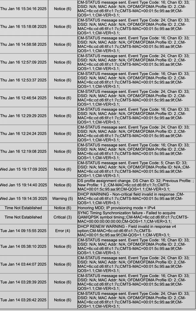

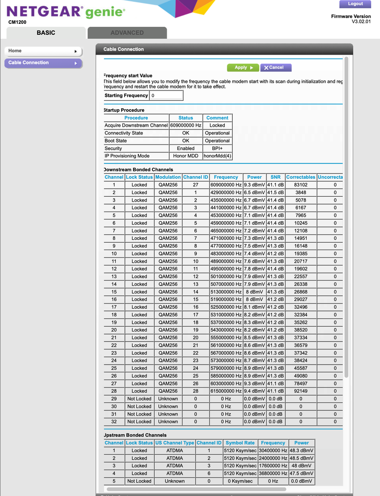

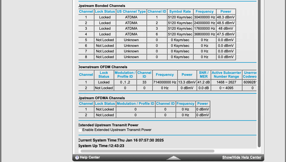

Hi can someone advise on whether the downstream signals look acceptable? Ive had occasional drops (few times per month) tied to SYNC Timing Synchronization Failure errors. I read that +/- 7 is the range but Im a littler higher on the channels output and not sure what the difference between the “Downstream OFDA Channels” at the bottom section vs the top section that is labeled “Downstream Bonded Channels”  means. Bonded I assume are channels that the modem has locked and actively threading signals. Appreciate any guidance on the outputs respectively.
