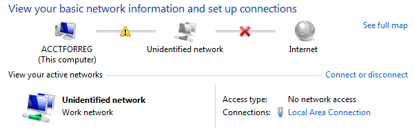

Unidentified network, no Ethernet or wireless connection
I recently moved into a new apartment, and this router has been with me for a few years. Yesterday out of nowhere it stopped working. I’ve tried restarting the router and modem. When I connect an Ethernet cable from the modem to my pc, the connection is fine.
Restarting the modem and router doesn’t work
Tried factory resetting the router with the button on the back, no luck.
The WPS light is off, and no matter how long I hold the button for it stays off. The wireless network is never detectable through mobile devices or laptops.
I’m stumped. Anyone have any ideas?

Check the cables are plugged properly or first plug out entire cables and the re-plug them and check if this works for you. Apart from that Change your DNS Servers and check if this works or try to manually add the ID address.
Hope this works but if not then read the article to follow more detailed steps and solutions: https://www.fixwindowserrors.biz/blog/resolve-unidentified-network-error-on-windows-10
