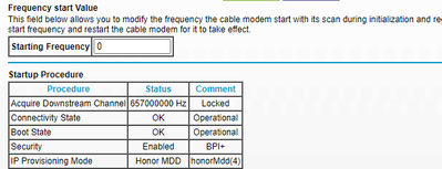

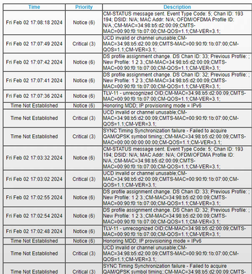

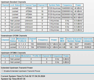

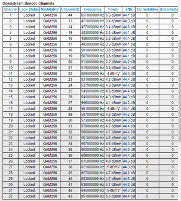

      Here are the logs:
      Information:
