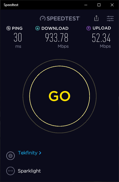

        Im getting good speed with my CAX80 on recent FW however mines now back in modem only mode until NG fixes the wifi issues:
