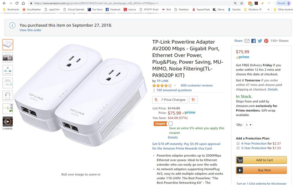

- Aandr13Jan 02, 2019Initiate
pvdublo7 - I have had the same problem you have described - I can get four of these to work, but adding the 5th takes the whole thing down (and I need 6). Unfortunately, I had to spend a few frustrating days before coming to this conclusion on my own. Luckily, I found this thread to confirm my suspicions.
You mentioned in your last post on 11/25/18 that your TPLink units are working perfectly. Can you confirm which model of TPLink units you are using and can you also confirm that they allow 6 devices to work? I'm over this with Negear, their technical support is worthless (as they won't even ackowledge this is a problem) and need a solution asap. It seems all of the competitors have the same general look and functionality and I am wary that they are all manufactured by the same company and all have the same limitations. I'm looking at TPLink Model TL-PA9020P at Amazon for $75.99 for two units. I would appreciate your help with this. Thank you.
- pvdublo7Jan 02, 2019Star
Yes you are right - the ones you are looking at on Amazon are correct.
For reference, here you go:
https://www.amazon.com/gp/product/B01H74VKZU/ref=oh_aui_detailpage_o08_s00?ie=UTF8&psc=1
The ones you referenced are the exact same as these - which I have SIX of them working PERFECTLY.
- Aandr13Jan 03, 2019Initiate
Thank you for getting back so quickly. I ordered 6 of the TPLink and will be taking the Netgear back. Very disappointed with Netgear.
