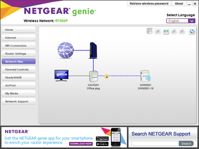

You don't say how you are accessing the plug. Have you tried using the Netgear Genie to manage the device?
If it works with your plugs – mine are older – you can get it to show the Network Map of Powerline devices
If you "right click" the device you want to manage, you should see a Configuration option. Up pops the usual browser page with maintenance options, including updating firmware.
Maybe this is what you are doing. It isn't clear from your description just how you went about this update process.
