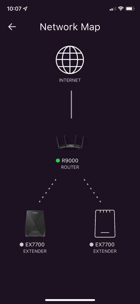

  • I have a similar problem as shown above, I can connect to my first EX7700, but not the other (right next to my router.  I verified latest firmware version, did a factory reset, but can only connect to the first extender via WPS or the app.  In the App, see both extenders (connected to my R9000), but one of the extenders shows up as a white box rather than the icon.
    Any tips or pointers would be appreciated.
    /RW
    • olympos1625's avatar
      olympos1625
      NETGEAR Employee Retired
      Hi @Rixter6969,
      Thank you for reaching out. How are the 2 extenders connected o the R9000 router? Are the 2 extenders configured as wireless extenders or access points? Did you try turning off the working extender and just have the 1 extender( affected) connect to the main router and see if it behaves the same?
      I am looking forward to your response.
      Regards,
      Oliver
