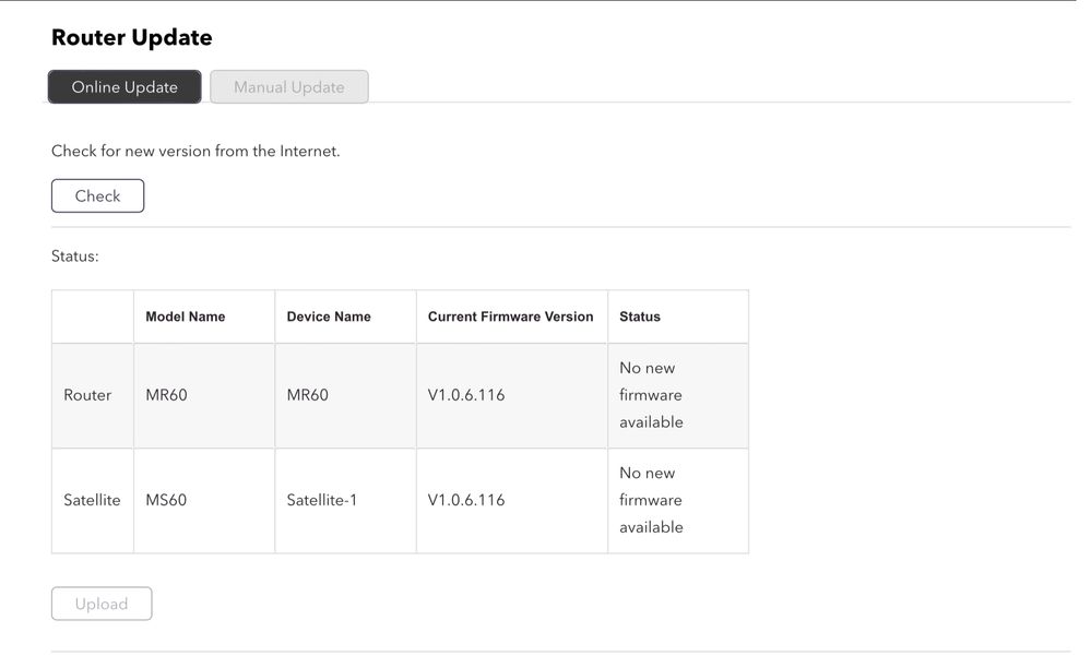

      I just got this router a couple of days ago, and I just went through the same process (before I saw your post). However, the latest version on the Netgear site is now 1.1.6.122. I updated my router and satellites to that version, and now when I check for online updates through the router's web interface, it says "service unreachable". I'm guessing it has something to do with the fact that it's running a newer version than it thinks is available through the online update system? So I guess now I'm stuck manually checking the website for updates, and manually uploading the firmware to the router. Hmmmm... Seems less than ideal....

        Thank you for reaching out. We are sorry for not being able to get back to you immediately. If you have the latest firmware, it should say on the Firmware Update or Router update page( under Advanced), " No new firmware is available." Did you try using a different web browser or different device?

  • I have the same issue of it not finding the update and I am stuck at 116.
    i also had the the same issue before I had updated to 116. 116 update occurred months after it was released on their website.
