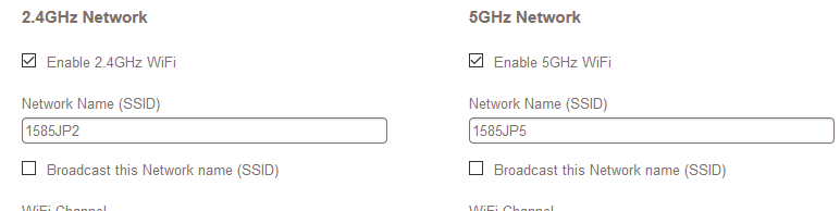

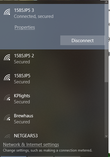

As you will notice in the picture below I have only created 1 LAN for each of the 2.4 and 5 GHz channels.
 For some reason however, my extender will allow itself to develop alternate VLANs ,which have not been created, and allowing devices to connect through these alternate SSID's(as you will see in the picture below.)
What can be done to prevent this anomaly from reoccuring?

      You should be able to see the images now.
      I see no evidence of any vlans.
      Note that if you are using one SSID on your network, the extenders and the router will still use different BSSIDs.  Those can result in multiple networks with the same name in your wifi clients.

      I've had this router for several years now. This is the base router. As you will notice I do not have bridge/vlan routing enabled or configured.
  • My base router(Netgear R7000) has both 2.4GHz and 5 GHz channels. I use my range extender(Netgear EX6200) 135' away, extending both 2.4 and 5 GHz channels. On my range extender I have connected to both channels on the base router using the SSID of the router. I then named both the 2.4 and 5 GHz channel with a unique SSID. After two to three months I started noticing that my devices were not being connected through the SSID's that I had created but a copy of the SSID. For example I named my 2.4 GHZ channel extend24; after a while my devices would connect to extend24 2 or extend24 3 or extend24 4. They were not connecting to the SSID I had made but a replica with a different number to it. I don't know how best to describe it.
      What you describe here is more an oddity in how some clients (say Windows) are handling the stored or known wireless (and sometimes even wired) connections and the sometimes weired logic of mapping network names with locations. We randomly see (or have seen) similarity things, and some times later it's like some "garbage collection" going on cleaning up and streamlining these multiple entries into a single one. You might ask Microsoft respectively the computer OEM which licensed Windows what does cause this.
      It's not that the wireless name which has changed.
