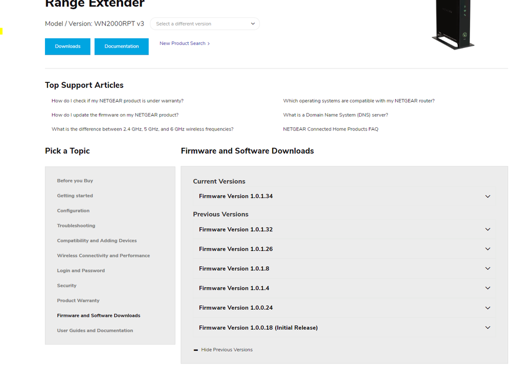

Based on the existing v1.0.0.24, and the list of Previous Versions, I suspect it's a WN2000RPTv3 – N300 Universal WiFi Range Extender

I downloaded the latest firmware for the v3 - 1.0.1.34. When I tried to upload that file "WN2000RPTv3-V1.0.1.34.img", I get an error "Error upgrade file module name! (Module name is "WN2000RPT")"
For kicks, I tried to rename img file, removing the v3 from the name, then I am back to the "error firmware region!" error.
Just in case - this is too much of a jump in firmware versions, I tried the same 2 things with the WN2000RPTv3-V1.0.1.4 firmware, and got the same results.
Thank you again for the help, but I am still stuck and unable to do the firmware upgrade.

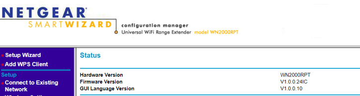

See below for the relevant portion of the status screen of my device.
- ewilAspirant
