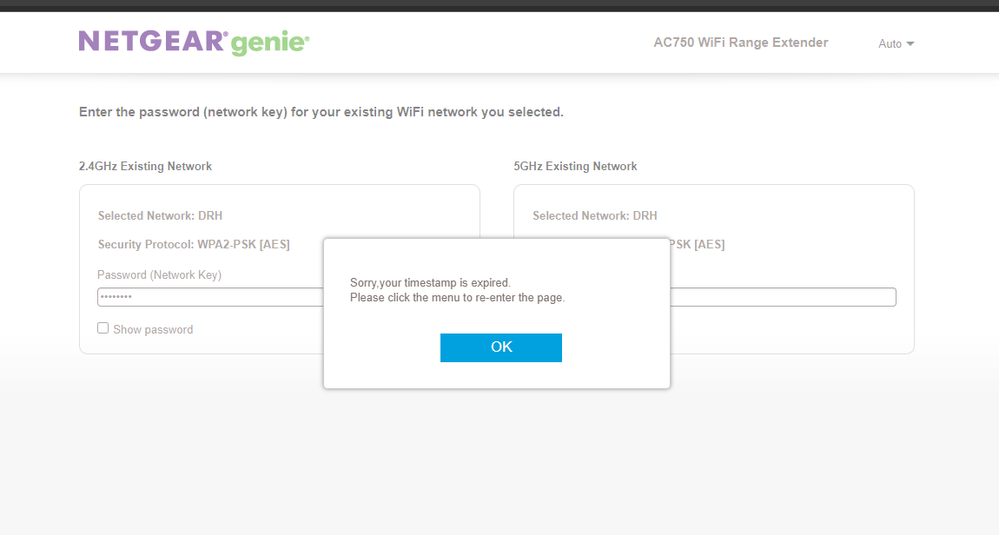

hello, i unplugged my Netgear EX7300 extender to go on vacation. when i came back and plugged it in my wife said it was no longer working? we had got it used a few years back and worked fine to get wifi outside to the she shed.
every log in attempt a window popped up and said " time stamp expired "
every factory reset said the same thing?
i get about halfway through the set up and it pops up.
i did almost make it to the end twice but said wifi not enabled and would not finish.
i pulled out another extender NetgearEX6100 ( 1 year newer ) that i have as a spare it it does the exact same thing?
i am on windows 10 with t-mobile Nokia 5G 21 gateway ( no WPS button ) i think?
i get 150 mbps solid all day long.
i tried setting up on Edge & Goggle chrome with the same time stamp issue?
i turned off the VPN and looked around in norton security but could not find anything preventing Netgear?
sometimes i get to the end of the setup but never connects?
so it feels like 2 issues.........
are these two extenders simply outdated or something?
any help would be appreciated.
thanks in advance

    I'd first clear out all browser caches before entering the extenders web pages.
    Be sure the extenders FW was updated as well.

      so i unplugged the extender
      cleared the cache on chrome
      restarted the computer.
      plugged the extender back in ( with factory reset )
      turned on the computer.
      proceeded to set up.
      after a few steps it pops again?
      thanks for the reply.
      anything else i can try?

        Can you get the EX setup using the Nighthawk app on a mobile device?
    • Dmnmay's avatar
      Dmnmay
      Tutor
      what is a FW update on the extender?
      not sure how to do that?
      • FURRYe38's avatar
        If you can get the extender setup and working thru the NH app, then try to log in to the EX web page to update FW using your PC.
