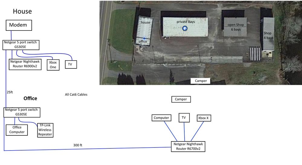

What I have. R6700v2, R6900v2, GS305E X2, what I want to do with what I have.
Just starting out. Funds are very limited. I have R6700v2, R6900v2, and two GS305E 5 port gigabyte switches. Will this work in the attached photo.I’m trying to cover the whole property with Wi-Fi and mainly get good internet to my camper before I go crazy.

    For the most part sure.
    the only issue/issues you  might have are:
    1. if its a modem only device, you need to go modem---router----then the switch/switches/other devices
    2. the other routers/extenders after the primary router should be in access point mode to prevent a double nat.

      That’s how I was going to set it up. The modem, main router in the house then the camper as an access point. Thank you, that helps a bunch. Now for the fun part setting it up. I’ll give an update when I got it setup.

        again, just make sure you have the router before the switch or you'll run into issues. Unless that modem has its own integrated router.
        good luck!
