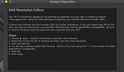

This is an example of the error I'm seeing when I try to access a webpage while on the extended networks:
 I ran Wireless Diagnostics and got these messages even though both Google DNS and the default DNS are in the queue. I have several reports from Wireless Diagnostics from which I can provide additional information upon request.

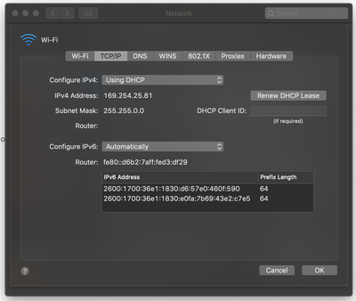

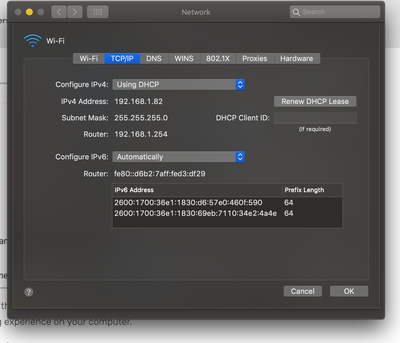

      This is the IP when connected to the main network:
      And this is the IP while on the extended network:
      *There is no router number, but I don't know why

        DHCP is failing when you are connected to the extender.  The Mac is assigning itself an IP address (169.254.x.x. addresses are self-assigned).  The router field is empty because the Mac doesn't know what to fill in there.
        Can you try clicking on the "renew DHCP lease" control when you are connected to the extender network, and see if it gets a 192.168.1.x address.
