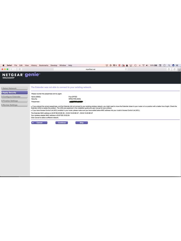

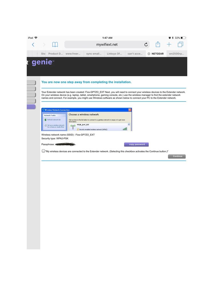

I tried manual setup using netgear genie (I have no network expertise) from my ipad. Initially I received message that mac address needed to be added to router’s ACL (access control list) see first attached screen shot.
But when I checked the router’s settings, ACL is NOT enabled.

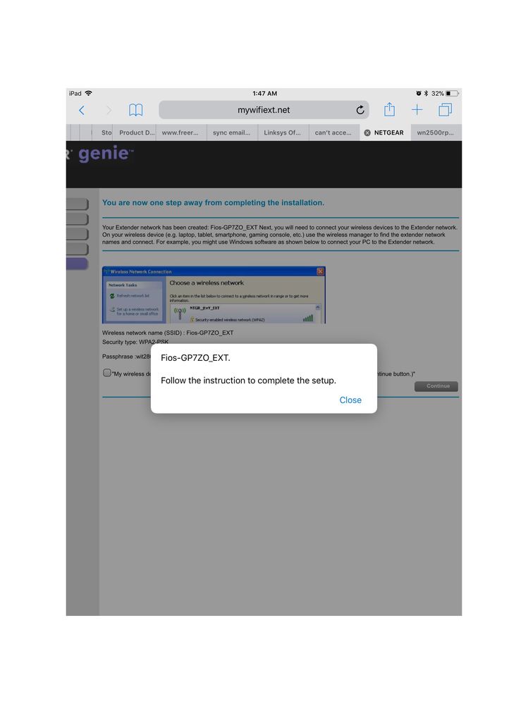

I reset the WN2500RP and tried manual setup again from my ipad. Every attempt after the first, I encounter this problem: I see the extender with my network name, but cannot maintain the connection to mywifiext.net long enough to complete the install. When I get to “you are now one step away from completing the installation”, I cannot check the box “my wireless devices are connected to the Extender network” because my ipad and iphone drop me from the network. See 2nd & 3rd photos.FIrst manual attempt2nd manual attempt

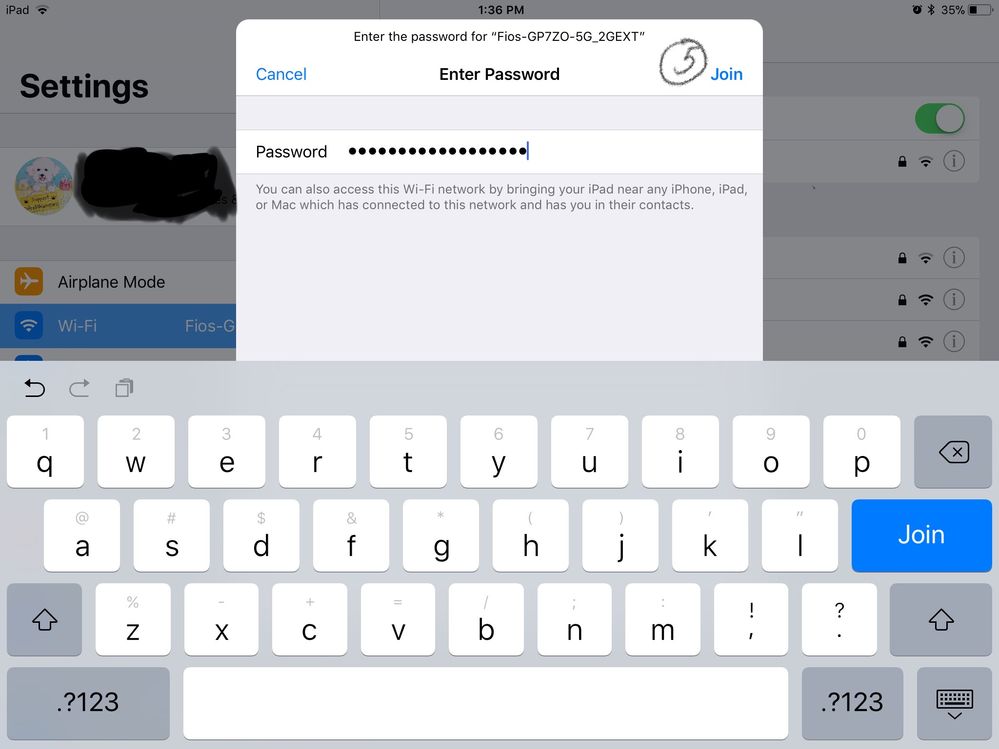

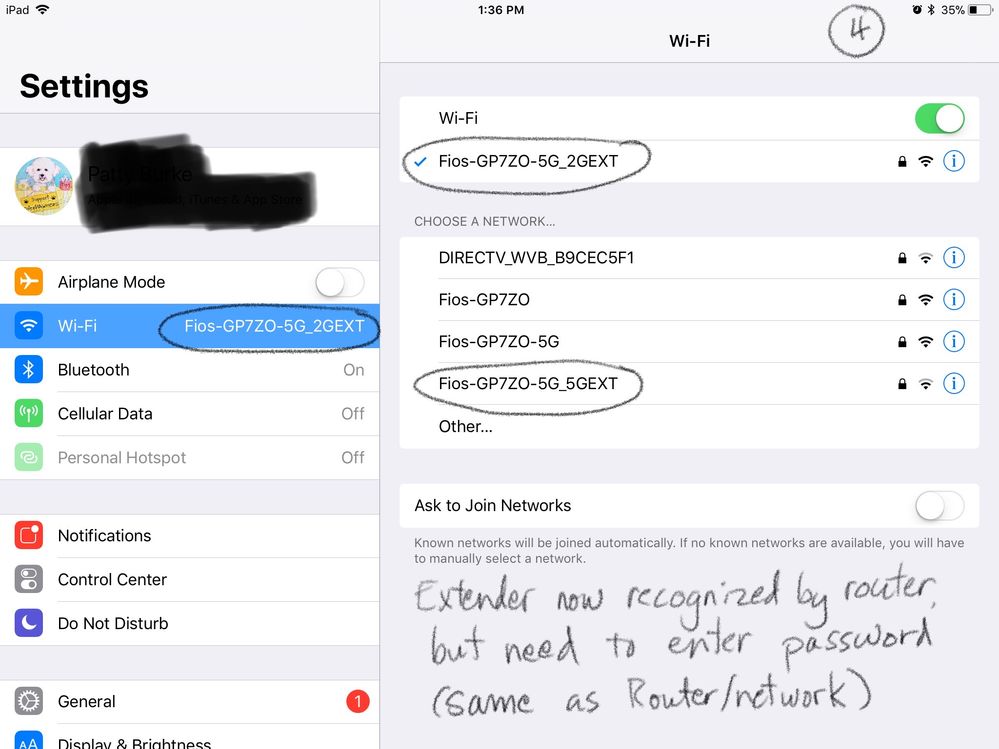

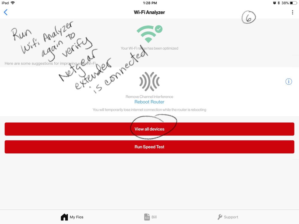

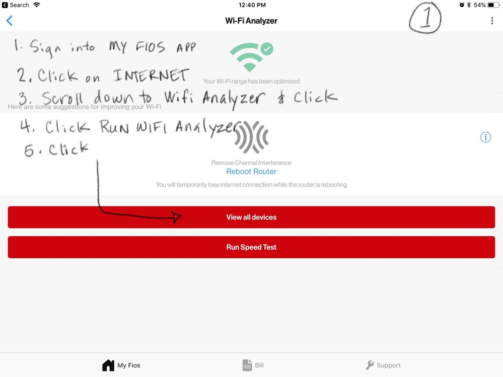

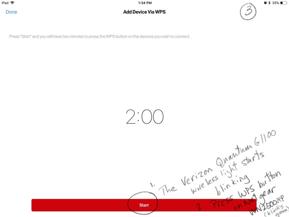

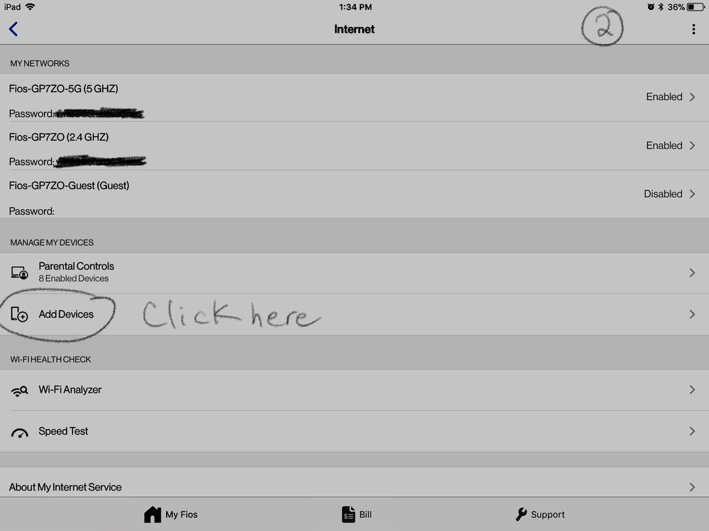

After spending several hours trying to achieve this, I was finally successful. I am attaching screen shots of the process that worked for me from my ipad, as I have seen this problem in other posts without successful resolution.
Basically
1. use the MyFios app on ipad to initiate WPS connection on the verizon quantum G1100 router
2. Press the WPS button on the WN2500RP netgear extender
3. As soon as yournetworkname_2GEXT and yournetworkname_5GEXT appear in your ipad’s available network list, click one to join and enter same password as your router’s network password.
4. From myfios app, run wi-fi analyzer again to verify that the WN2500RP extender is now connected.
I hope this saves someone from the aggravation I experienced. It was very simple to manually connect this extender to the previous verizon router and I am not sure why I was unable to do so with the Quantum router. But I am now getting a strong enough signal from the extender to connect my smart tv to the extender network and get good quality streaming.
