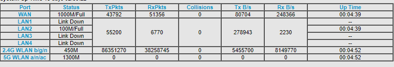

Seems like my upload didnt work for my port stats, hopefully this one works stats
For whatever reason, the one and only active LAN connection negotiates to 100 Mb/s only.
Typical cause is for wrong link rate negotiation is the cabling, or in the physical ports. Start with using a different cable.
What device (computer, switch, ...) is connected to the LAN2 port?
Has a factory reset and setup from scratch been performed since last FW update?
Has this router seen near 900Mpbs on a wired speed test before the update?
