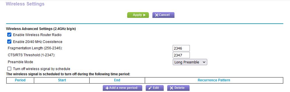

What is seen for your model router Under Advanced Tab/Advanced Settings/Wireless Settings?
- xytsrmTutor
I presume one reason those are not seen maybe that those are automatically handled now days as those are seen much anymore in router UIs. Older routers had those features. Also maybe that due to wifi chipset used, something that isn't needed or used. CTS can be changed however default is recommended. Ive seen 64 used in newer generation routers as default, however seems to cause problems for some. 2347 seems to be the norm and works best.

All routers, whether user adjustable or not, transmitt a beacon containing the router SSID and additional information at regular intervals they can vary from router to router, but are usually in the 100-200ms range. It's necessary for specific clients, that need to sleep between beacons to conserve power, to know when to wake-up to maintain connection.
I found this, though a different router model, it shows what NG uses for what your looking for:
